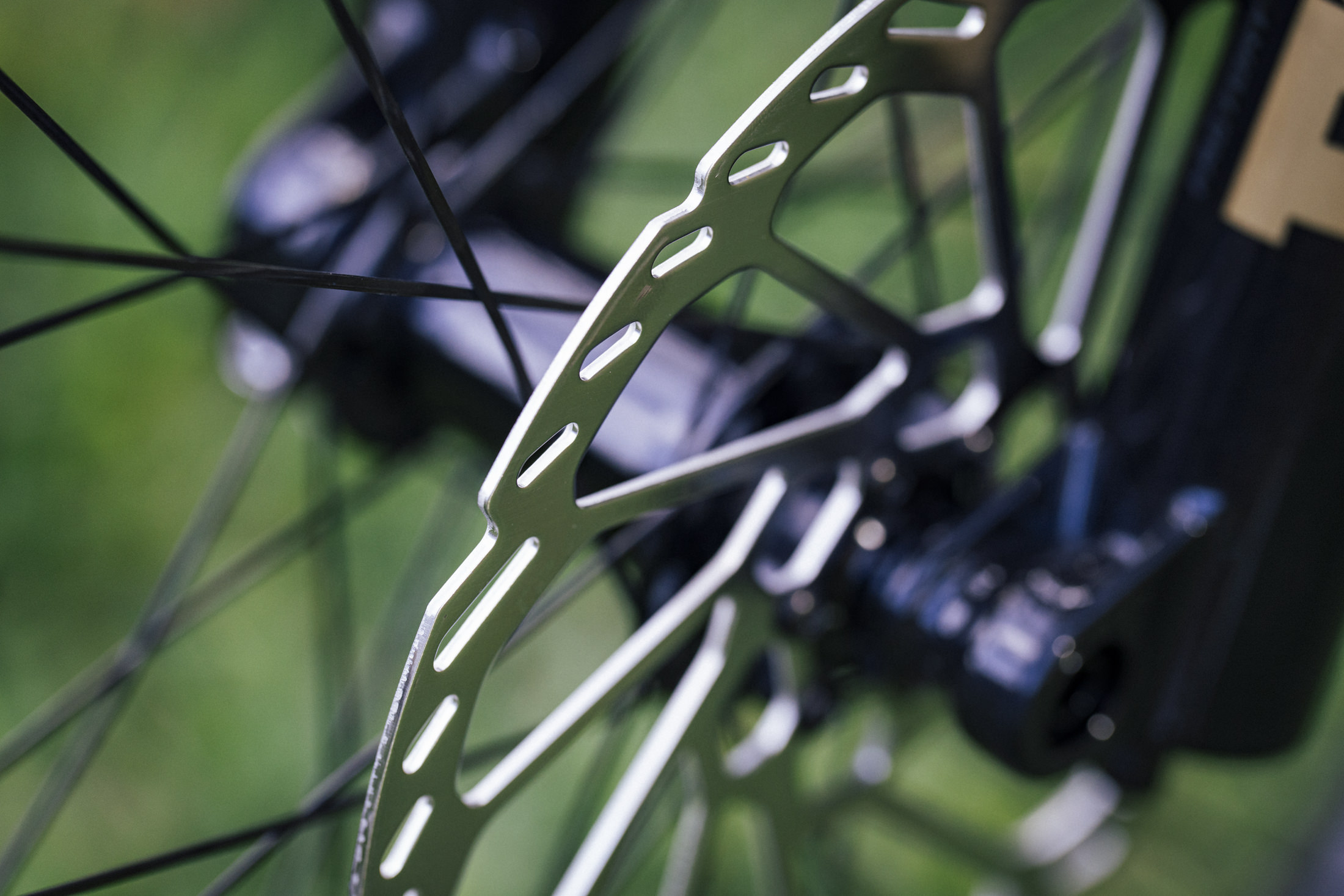

Shimano new thicker 2.2mm rotor, the RT-750, in 200 or 220mm diameters is now officially live. Their mountain bike rotors have historically been 1.8mm thick and tapped out at 203mm (except for the cheaper RT-66 that was available in 220mm).
The RT-750 is offered in the usual mounting styles—Center Lock (CL750) and 6-Bolt (6B750). Unlike Shimano’s XT or XTR rotors, it does not feature a two-piece design with Shimano’s Ice Technology.
The rotors are claimed to offer all the usual benefits of going bigger and thicker 😶—more power/bite, better heat management for consistency over long runs and less chance of bending.
RT-CL750 220 3
RT-CL750 220 1
We’ve seen the new rotors raced at World Cups this season, so one can assume they provide some benefit over Shimano’s previous rotors. But the optics of running what appears to be stamped rotors doesn’t immediately scream performance compared to say SRAM’s HS2 rotor.
Dropping a thicker and bigger rotor 2026 isn't super newsworthy, but it does feel very Shimano. The reality is that many other brands have offered thick (or thicker) 220mm (or larger) rotors for many years, and the RT-750 is competing in a large pool of gravity rotors.
I've asked for weights and more detail on how the rotors are made. I'll update the article if/when any new information is received.

i'm ready for the dislikes, but hell no, 262 gr for a 200 rotor is nuts, plus, it doesn't look flush just like the cheap shimano rotors that seem stamped, and the price is nuts too for what it is, Radic HD rotors are cheaper, thicker ( 2.3mm ) and 70gr lighter per rotor... i mean 140gr just on the rotors without any sacrifices and a better quality rotor overall, meh, i feel shimano has lost it in the last few years

It goes in the right direction for thickness, but definitely not for quality.. Stamped rotor for that price? Nah. In the end, once the rotor is bedded in, it probably provides 99% of the power of a laser cut rotor, but it takes longer to bed in, looks horrible and worst of all, cheap. Aliexpress rotors that cost 10% look way better ....
Do better Shimano, you're lagging way behind everyone else.
6/17/2026 1:08am
stamped rubbish for the same price as a hs2?
and $10 cheaper than the Really good TRP r5 rotor......
Much like apple users... shimano fanboys will lap this up.

The 3D renders look a lot better than the reality...
Belated edit: closer inspection of the renders on Shimano's website (the first image in the OP) shows finishing that wouldn't look out of place on a mechanical watch movement. The seamless chamfering with mirror polish to accentuate the surface brushing looks very luxurious.
Even if these are technically flat and level, I've been bitten by stamped Shimano rotors too many times.  I'll stick to laser cut/machined discs.

For what is worth, min thickness written on HS2 1.7mm. On these shimano rotors it is written 1.5mm. So basically, on HS2 you have only 0.3mm of useful brake layer. On shimano it is "whooping" 0.7mm. So they might last a lot longer.

Purely based on the pictures, it looks like they might have optimized layout for stamping. Or/and improved the stamping process. Stamped RT66 has some low and high spots, that can produce some vibrations. From the pictures alone, this one looks better.

Confirmation they are stamped? The pics I saw of rotors mounted on WC bikes showed edges radiused on both sides. That does not happen from simple stamping, a secondary operation would be needed.

Correct, they are just two piece, but are firmly riveted. In that regard the new centerlock rotors are exactly the same. Previously Shimano did make 2-piece 6-bolt rotors too to save some weight and have a stiffer rotor? They would need it with IceTech anyway because of the middle aluminium layer which doesn't do much for stiffness. So I guess those are, in 6-bolt at least, 2-piece out of necessity first and for everything else second.
I see Flow mountainbike has these weighed and they are indeed 262 grams for the 6-bolt (single piece) variant. There are many spokes so it should be stiff at least.
As for cut vs. stamped, here are Flow's pics of the edges. They are suspiciously rounded and the edge does correspond to a stamping operation. What I would like to see is the back side. If it's the same rounded-wise, then I'd say it's not just stamping. For now, to me it's inconclusive, but suspiciously stamped.
https://d36myxw5t262l6.cloudfront.net/wp-content/uploads/2026/05/29130300/Shimano-220mm-2.2mm-disc-rotors-21.jpg
https://d36myxw5t262l6.cloudfront.net/wp-content/uploads/2026/05/29130303/Shimano-220mm-2.2mm-disc-rotors-22.jpg
https://flowmountainbike.com/fresh-produce/shimano-2-2mm-rotor-rt-cl6b7…

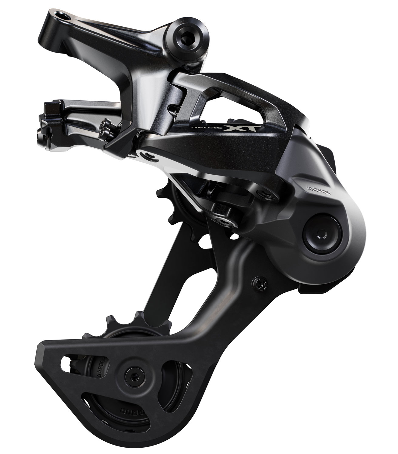

Vorschau XT RD-M8200 12-speed Rear Derailleur
It's out. I don't see any floaty bois.

People keep on calling them stamped but are they actually confirmed to be stamped?
6/19/2026 9:07pm
Straight 200mm is long overdue for Shimano but where's my 240mm for my 32" wheel bike? We'll need more leverage on the bigger wheel Shimano... 😅
Evil96
909
8/21/2014
Portogruaro, VE, IT
6/19/2026 10:04pm
Just look at them, there’s no way laser cutting folds the edges like that
6/20/2026 3:54am
The edges are rounded on both sides.
Stamping/shearing does not normally produce that result.
