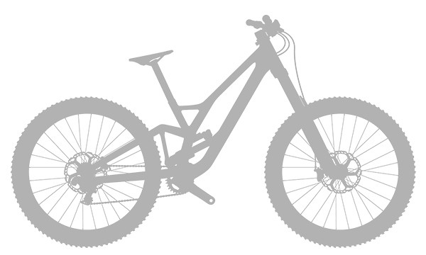

qblambda if you're making that silhouette any more detailed, the bottom link (there should be one connected to the vertical one) should be quite long for the shock to have full stroke.

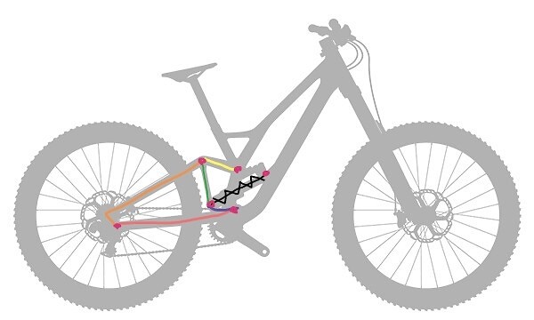

Few minutes of Photoshop later...
I'm thinking the upper link goes through the seat tube and compresses the shock from the front. The rear end of the shock is attached to the chainstays. It's not a dual short link system, but a Horst Link with the chainstays/main pivot possibly on the bb.
What is the point of the vertical piece then? Plus if you look closely at the photo, you can see the vertical link gets thicker or bigger towards the bottom, where the shock eyelet is. There is no such thing on the chainstay visible.
Plus that having a link on the chainstay on such an angle would put immense stresses on the chainstay (with it being just a link between two pivots, it's in fact mainly a 'pull link' only, plus the torsional stresses - having the shock mounted to it would cause severe bending stresses, making the part heavier to carry to loads).
And given the top link and shock orientation, the top link would have to be bent upwards quite a lot to get the ETE of the shock in. That would mean the shock would be mounted in both ends (by the chainstay and by the rocker) at very shallow angles, which is never a good thing for force transfers (you would be having massive axial forces in all links when squishing the shock).
It's possible of course, it just doesn't make sense.
I'm thinking the upper link goes through the seat tube and compresses the shock from the front. The rear end of the shock is attached to...
I was wondering the same, like a bigger rocker linkage til I noticed the front shock mount is actually attached on the downtube. You can see it bulky there, looking like the previous generation of Demo.
And like Primoz said, that vertical link would have no sense then. Some pivots might be hidden around the bottom bracket...
Sorry, I ditched my photoshop talents for that one. It might be that way
Yup, you're right guys. Having two links scissoring the shock forward (one running from the seatstays/upper link to the shock, another from the shock to the BB area) when the wheel moves upwards makes sense. I didn't notice the forward shock mount until you mentioned it.
