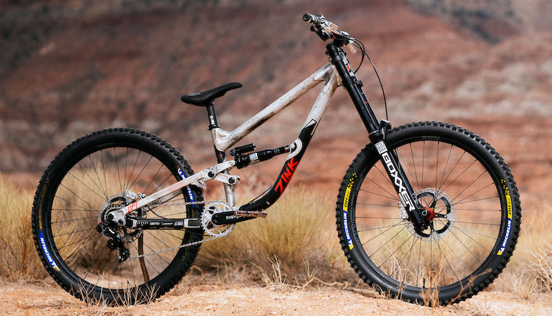

Zink Zader, dual 27.5, kinda funny geo. They're saying large is for 6'+ only, yet has a 476mm reach and 429mm CS
Zink Zader
I think you meant “kind of FUN geometry”.
As a person who gets more than 100 bike park days a year, this is way more in line with how parkrats of all ages enjoy riding… ymmv

mickey wrote:
I think you meant “kind of FUN geometry”.As a person who gets more than 100 bike park days a year, this is way more in line...
A friend of mine got a bit of an extended test on the Zink trail bike and loved it..   Maybe not a bike for me, but I'm thinking my son would be all over it. Different strokes for different folks...

Large Geo looks absolutely perfect for somebody. Who’s 6 feet tall again this isn’t for somebody who wants to ride blue flow trails. It’s a purpose build jump bike so the shorter reach in short change stays are probably perfect one in the air.

This looks like a sick bike for someone who is super sendy and very talented.
