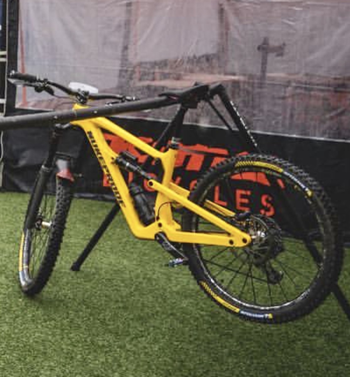

So will norco release 2 bikes or was the double crowned bike we all saw a super enduro being thoroughly tested?
Possibly one bike with two stroke options for the shock? Maybe 170-180 & single crown vs 190-200 & dual crown?Also didn't someone mention a bottle mount they spotted on the DH bike?
Possibly one bike with two stroke options for the shock? Maybe 170-180 & single crown vs 190-200 & dual crown?Also didn't someone mention a bottle mount...
I saw the DH proto in the Whistler Bikepark, and it did have bottle mounts. It did not look anything like this though, with much different proportions. The seat tube was in a different position. I think they are doing the same thing as Specialized did with the Demo and Enduro, using a very similar suspension design, but slightly different looks and proportions.
