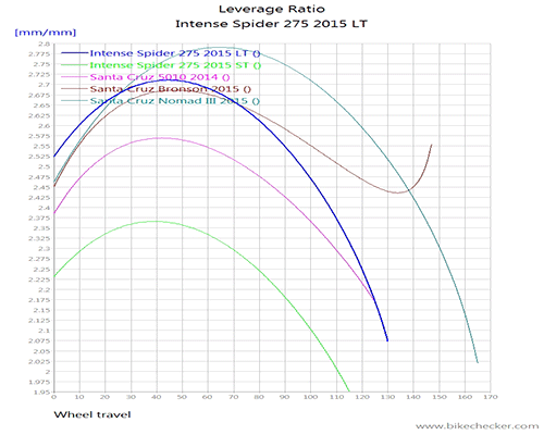

How would a coil shock work with a 2015 spider 275? The VpP suspension. I am looking at the dB inline. I am looking to get better small bump compliance.
7/22/2018 6:27pm
I can't speak to how it will work with the spider, but in my experience the coil IL is fantastic for small bump compliance. And you will climb better. Magic carpet ride.
Durango, CO, USA
7/23/2018 12:21pm
How would a coil shock work with a 2015 spider 275? The VpP suspension. I am looking at the dB inline. I am looking to get...
A coil shock would likely work pretty well on the Spider. Overall progression should be sufficient, and the coil will help to undo the negative small bump effects of the initial regressive portion of the travel.
http://linkagedesign.blogspot.com/2015/02/intense-spider-275-2015.html
