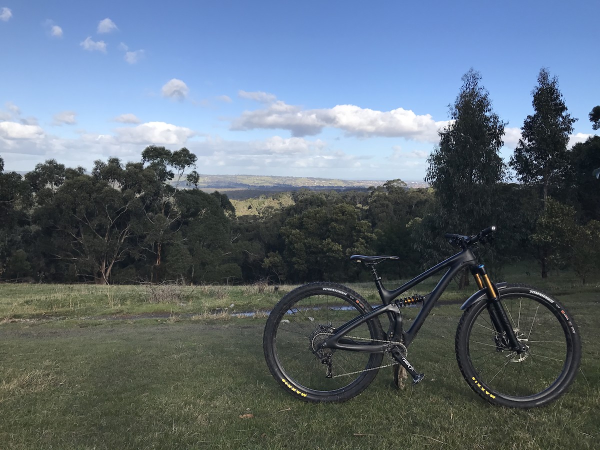

I put a Canecreek Inline Coil on my yeti 4.5. It has been awesome. Bike linkage is linear, so run a firmer spring (20%) sag. I don't often bottom it out and with a coil, the small bump sensitivity is still great. Went this option as it's the only really adjustable shock you can fit on this bike. I wanted an X2 but they don't make them small enough. It has been great and compensates for the shorter back to front. Wanted to share as I search the web for info on this before I did it and came up with nothing. Here is a pic of the bike

You mentioned Reign here. If I may, could somebody advise about choosing a shock for Reign 2 2016. Its 200x57 (2.25 stroke), about 75 kg (165lbs) rider weight, 150 mm (5.9ins) rear wheel travel, very lite enduro without serious drops, need maximum plush. Candidates are Ohlins TTX 22 M vs Fox Float X2 2Pos EVOL Factory 2018.
1280
Grand Junction, CO, USA
10/17/2017 1:36pm
ka81 wrote:
You mentioned Reign here. If I may, could somebody advise about choosing a shock for Reign 2 2016. Its 200x57 (2.25 stroke), about 75 kg (165lbs)...
That's a tough one in some ways, only because the leverage ratio is very high, especially off the top.
Personally, I think you'd be most well suited to a Float X2 with no tokens as its highly adjustable (no spring weight monkeying around), will be very plush and if you do have problems bottoming, you can always play with the tokens and whatnot.
I know a lot of others will steer you toward coil, but I've felt most riders have the best time with a high end air shock such ast the X2 when it comes to actually getting it to work right...

Why wouldn't the DHX2 be in the running since the Ohlins is a coil as well? I have the same frame as you and love the DHX2 on it compared to the Monarch Plus RC3 that I had previously. I would bet the Float X2 would run pretty damn close to the DHX2 after watching Johan's video above.

Well, I choosed something exotic in coil - ohlins, i see dozens of bikers simply adore it. In air choosed just from the priciest.

The biggest problem with coil is getting your spring rate right. When the leverage rate is high, it can be extra hard to find the right spring rate IMO and no calculator is all that awesome in my experience.
Thus it can be pretty expensive and honestly a big PITA when compared to hooking a shock pump up and going at it.
My personal opinion, that is absolutely subjective and open to debate, is we should lean air 90% of the time as the performance is excellent in top trim (Float X2 or Super Deluxe), is easier to tune and offers more spring rate tuning options (tokens)
Yes, coil does offer an unmistakable feel, but overall I've (personally) found even when its utilized correctly (in a progressive leverage ratio bike) its performance benefits are a bit overblown, especially if you aren't chasing fractions of a second on the race course or don't want to invest in a number of different springs...

There is the spring rate issue but I guess I got lucky on the first try. Boom, 30% saggy McSaggerton. My whole point was to share my experience with coil and air on that frame. I am a bigger dude though so that may play in as a factor with air shocks. Then again I haven't tried the Float X2 so my opinion might change after some experience with it.
