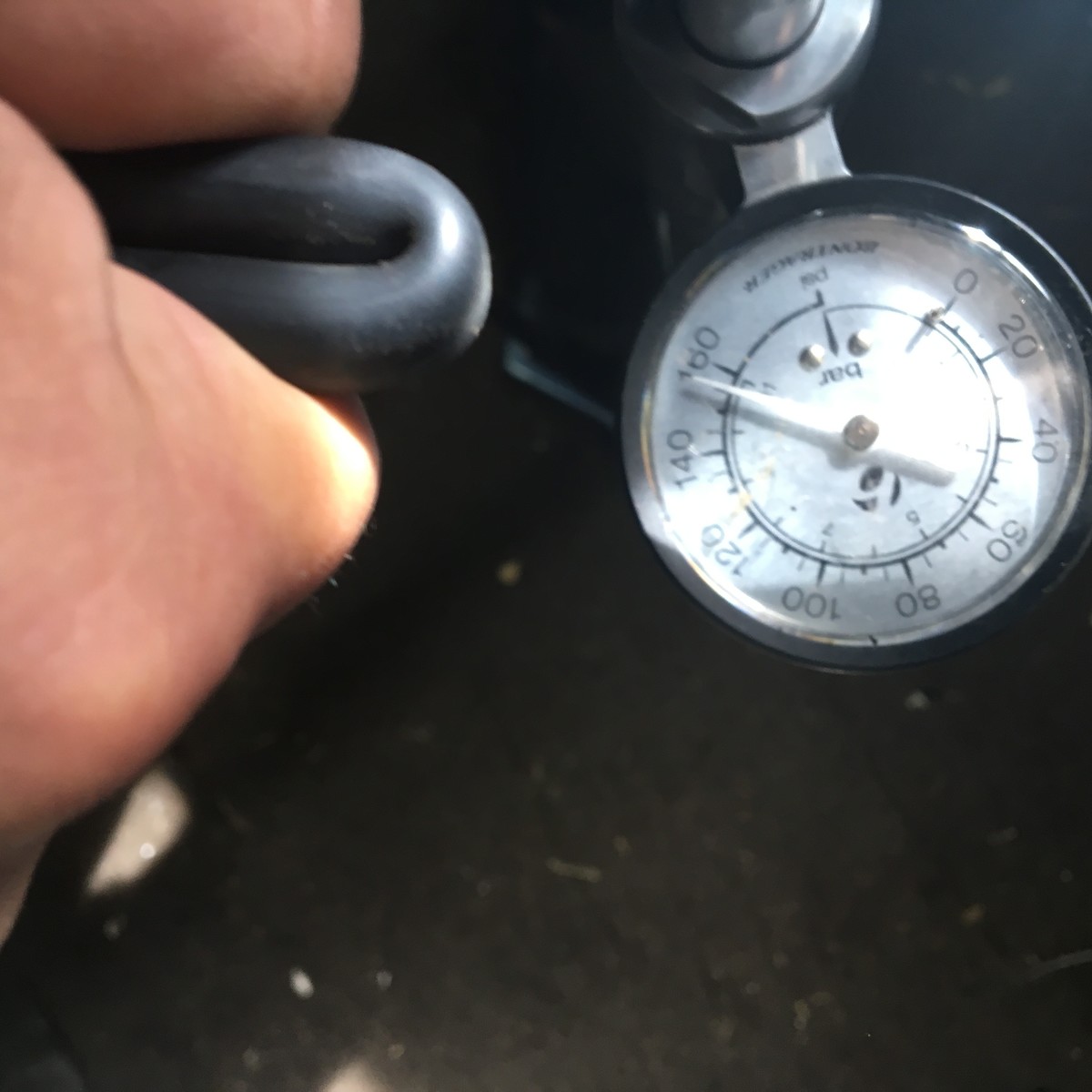

Pinch your floor-pump's hose towards the head and pressurize it by pumping a couple times. W/ the valve core removed, release the built up pressure and continue to go HAM on your pump until it seats. Works some of the time, all the time.
