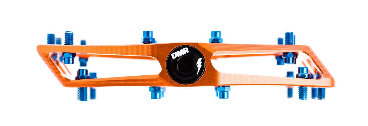

On my own personal level, I'm stoked because DMR just unveiled their King Pins. I've been running the Vaults for a while now. There are a host of damn good pedals, with the likes of Burgtec, Nukeproof, HT, and Deity all have pretty long pins stock too.
