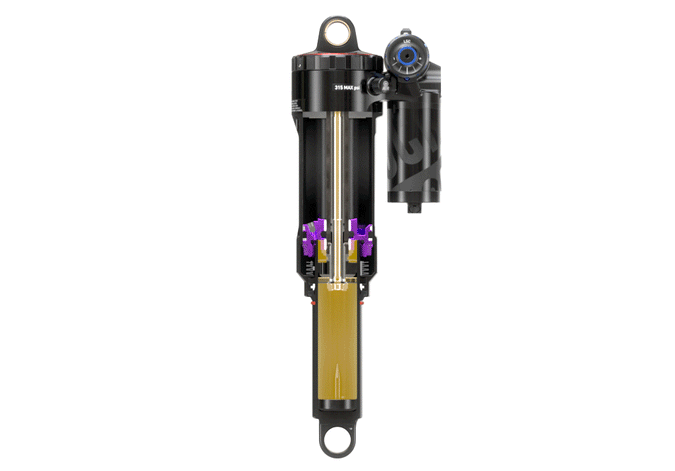

For the air SDs, the HBO is a needle shaped thing in the base of the air shaft body, which is not removable.  It's length corresponds to the stroke length so that it engages at a specific percent of travel (I want to say 20%).  If you just remove the travel limit spacer without changing the shaft body, you will still have HBO but it will activate later.  You can buy the complete body assembly with HBO for around $90 (also will have correct sag marks too), but that will require rebleeding the shock.
Dave_Camp
463
1/12/2026 6:50am
^Correct, but the opposite- if you remove the travel spacer, the needle will activate at the same stroke, but since you have more stroke (from removing the spacer), you'll have more time in the HBO zone.  I can't remember if there's anything for the needle to run into or not if you increase the stroke 5mm.
You could always get a non-HBO body and run that if the HBO ones are out of stock.
Graphic:
https://cyclinic.com.au/cdn/shop/products/my23-sdlx-hbo-v4.gif?v=1676249835&width=675

So I went from 50mm to 55mm stroke on my Super deelux, So in short I'm running less HBO than I was before and if I want more HBO I need the 55mm Damper body?

Yes.

No.
The 50mm needle is actually longer than the 55mm needle.  So if you run a 50mm needle with 55mm of stroke you will be activating the HBO earlier and for longer (as a % of the stroke).
Think about it:
50mm needle activates the last 20% of 50mm = last 10mm of stroke  (40mm free stroke until HBO).
Same 50mm needle in a 55mm stroke shock = 55-40 = last 15mm stroke have HBO or 15/55=27% HBO
I can't remember the % it's either 15 or 20.  But either way- increasing stroke without changing parts will give you more stroke in the HBO zone.

I was thinking ingen reverse.
But how does the HBO reach bottom?
The needle is cone shaped, but will it at some point completely block the hole, and case hydraulic lock if its to long?

it's a cone on top, then same diameter all the way down.  But I can't remember if it will run into something else if it's too long...
best to just run it the intended way- ie correct body/needle for the stroke.
