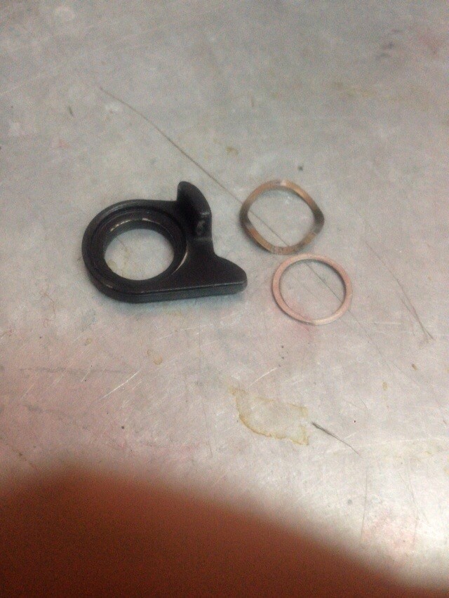

Hi guys well yesterday was the fifth time this pice broke (located between the drop out and the deraileur
Im currently using a v10 and this pice only breaks on the rough fast parts (when the rear suspension is working a lot)
Pleas help

I'd take it into your LBS and tell them what's going on and see if they can warranty it though SRAM. This is a known problem I've seen in the past so they should take care of you.

I've sometimes had a derailleur rattle a bit, which depends on the derailleur hanger a little, angle, some little things like that. I have put a thin pedal washer between the hanger and that piece you are talking about, and it prevents any movement and keeps it more solid. That might solve your issues.
