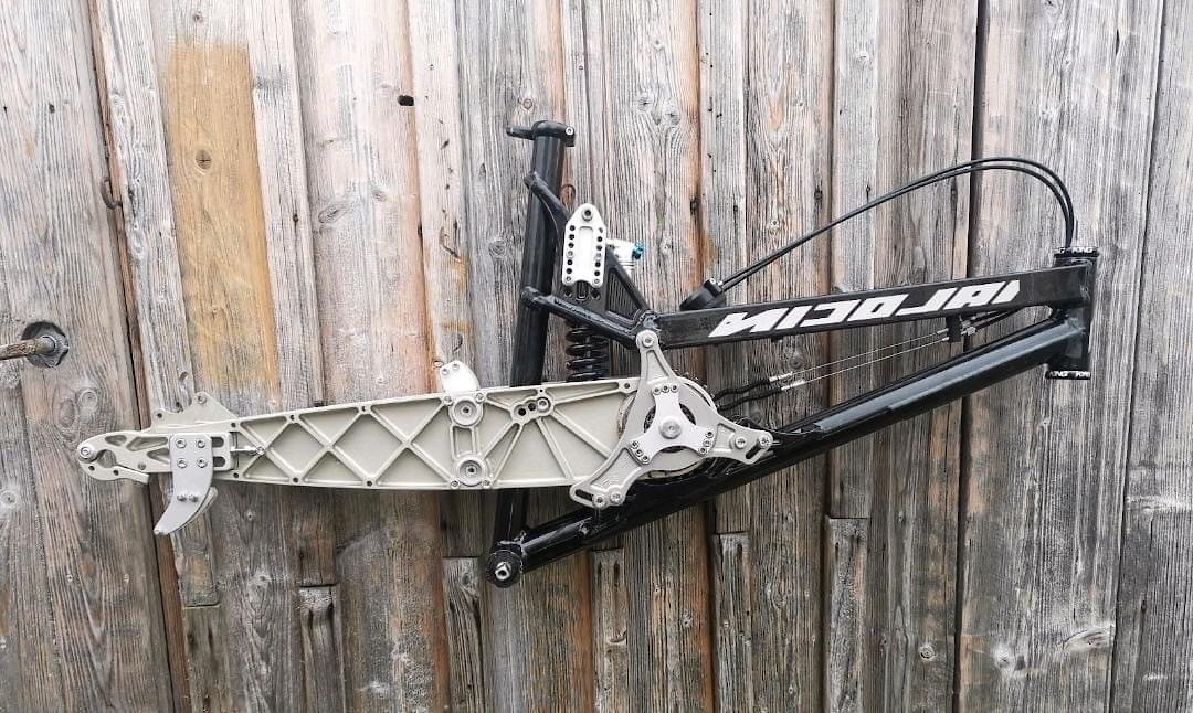

Maybe Specialized are going down the Ancillotti route

loving the ktm style (cast/printed) chainstay 😻👌
I'd be surprised if that wasn't simply milled
