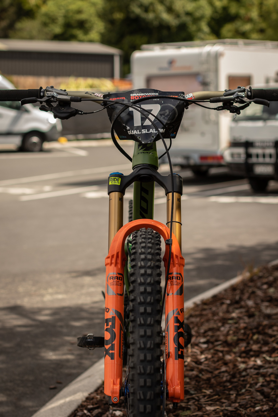

So I am 100% sure the new 38s are on their way but have a look at that 36 on the right! Is that a camouflaged 38 with 36 decals on it or a a new lower leg assembly for the 36? Difficult to tell wether the stanchions are bigger by just looking at the pics!
3/25/2020 6:10 PM
The one on the right looks like a camouflaged 38 as the crown is the exact same as the non kashima 38.

Check the arches too: the two on the right are the new style, the one on the left is the current style

And the new 36 chassis.
