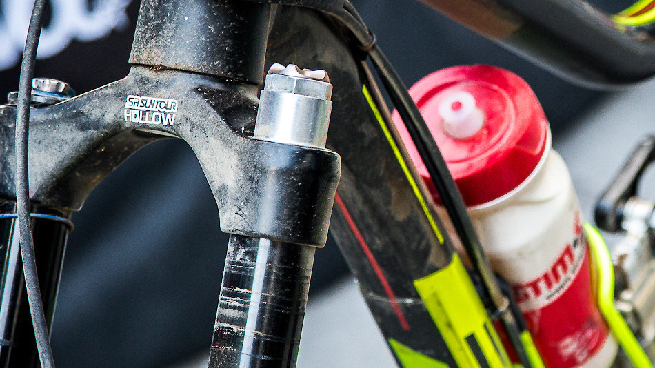

brash wrote:
Steve from Vorsprung was testing a very modified Lyrik when I spotted him in Queenstown at Skyline.
Looked like a giant air reservoir/piggyback at the base of the left leg.
I quizzed him about it, said secret squirrel stuff and commended me on my coil conversion. Wish I snuck a sneaky pic now.

BOS had a piggyback fork back in 2008:
https://m.pinkbike.com/news/Bos-suspension-preview-2008.html
3/21/2020 11:56 PM
Thats similar to the older 2004-ish white bros DH3 but both are an IFP on the damper side. The above is suggesting a 3rd air chamber in the air spring to adjust bottom out?
3/22/2020 4:56 AM
Edited Date/Time: 3/22/2020 4:58 AM
If I understand the Showa fork correctly, they're not using the fork legs as the spring casing like we do in MTB. One thing to note here is that it's an upside-down fork, so an analogy with a standard MTB fork would mean you would need to flip the components upside down to get the same layout.
Anywho, they use a spring cartridge. The two valves on the top are used to fill the inside of the cartridge and the outside of the cartridge. The inner one is clear, but to put this system into a MTB fork, the main spring volume would be in the lower leg with a shaft running through the upper sliders. Then the sliders are also sealed against the cartridge (unlike what we do with cartridge dampers for example) and that volume is pumped with the low (~7 psi) pressure from the top.
The piggyback in the bottom i suppose pressurizes the negative spring inside the cartridge through the hollow shaft (I don't see another way how to do it otherwise). In MTB we have a timing port to equalize the pressure with the use of only one valve. A similar method to this piggyback (infinitely adjustable negative spring) was used by Rock Shox with their Dual Air products (separate valves for positive and negative springs).
Why use the third chamber in this way is a bit beyond me, I don't see a way how it would modify the spring curve significantly (you don't alter the progression ratio significantly, unless it has a completely different volume to the main chamber, but in that case you don't exhibit much force anyway). Maybe they just had to seal off the lower to prevent all of the oil from accumulating there and then added another valve and sold it as a feature? Given the low pressure in there, this seems like a logical train of thought and makes the third chamber more or less a gimmick.
EDIT: as for the BOS piggyback, yeah, it's on the damper side. This is normal for high end moto forks, at least on the road. Might be connected to the general layout of the fork though (no offset, spring and damper each in their own leg or doubled up, etc.)

Formula and Ohlins are already using the triple air chamber concept, and the Runt and MRP ramp control are essentially that as well although all have variations in execution and concept.
Regarding using full travel, in my opinion, you only want to be using ONLY as much travel as necessary to dissipate the force of the bump so that you can maintain geometry and ride height and hence handling more consistently.
Bottoming out in itself is not bad if it is necessary to absorb the bump, but if the travel required to absorb the bump is say 120mm and you have 160mm of travel, so you set it up to use all 160mm on the same bump, you are probably setting your suspension too soft and likely compromising your mid stroke support in doing so.
This is all however still subject to personal preference of how you like your suspension to feel at the end of the day. Some people prefer the same bump force to be absorbed more linearly over slightly longer travel while some prefer a more progressive or stiffer setup that would use less travel but cause the damper to work harder and create more heat etc.
3/24/2020 1:07 AM
I never said 'use up your travel on a root'. I said use up your travel on your average ride, don't leave 1 or 2 cm of it left for 'just in case' situations.
As for ramp control, it's a volume changing module, just like tokens are. Only that it's toolless. The Formula DH fork does have 3 air chambers, but the AM one has 2 chambers (separate negative chamber). A more important thing is that Formula uses their foam 'tokens', that can compress and thus add variability in the volume reduction they provide depending on the surrounding air pressure. I would like to see how their bottom out control works though.
3/24/2020 1:25 AM
The Formula DH fork is the only one that uses 3 completely separated air chambers all with their own valve, most of the others use interconnected chambers that adjust and/or equalize between them.
Using the Runt in say a cane creek helm fork (not sure they are compatible) would essentially create a 3 chamber fork, although I think most brands have decided that a self equalizing negative chamber is a better option and are playing with the volume rather than the pressure thereof.
The ramp control is kind of a speed sensitive interconnected air chamber token system. It’s actually quite a complicated little device in its concept.
