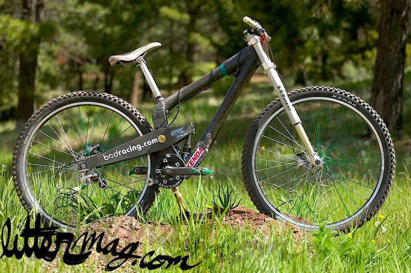

hard to believe it's been 6 years since steber experimented with a 29er DH bike.
we're hearing rumors of some brands working on slack (like DH slack) long-travel (170, 180mm) 29ers that are made to pedal. is this the future? developing a 29er platform means a 27.5+ swap could be an option. the Enduro 29 has been a hit for a lot of people. can they go bigger and slacker and remain functional?

here's the full gallery w/ audio
http://www.vitalmtb.com/photos/features/BCDs-Carbon-29er-Downhill-Bike-…
