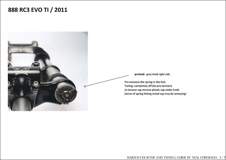

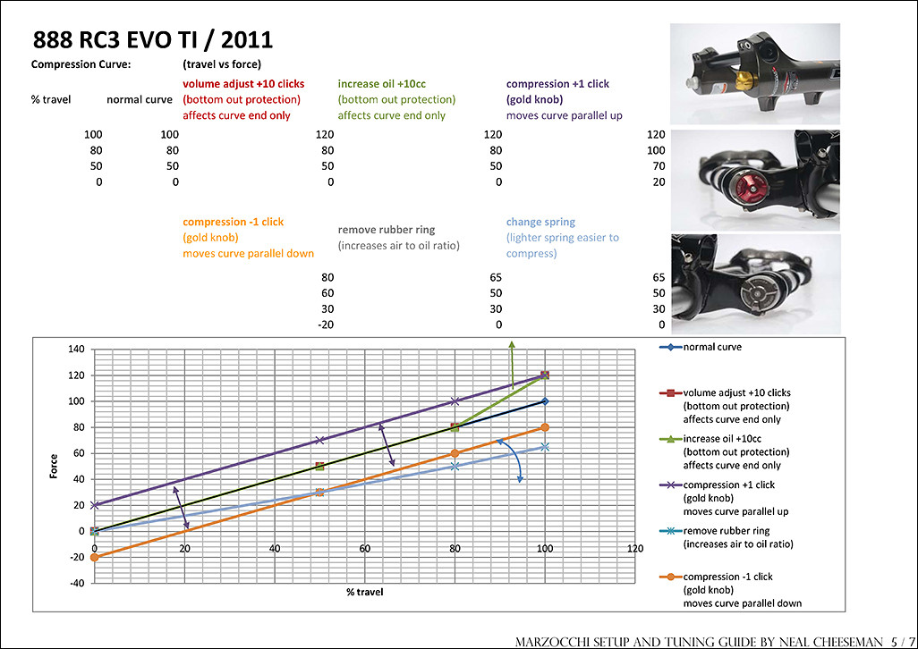

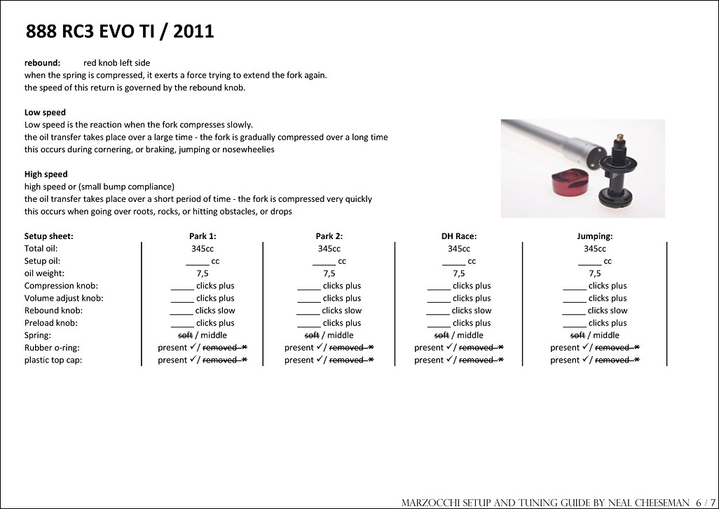

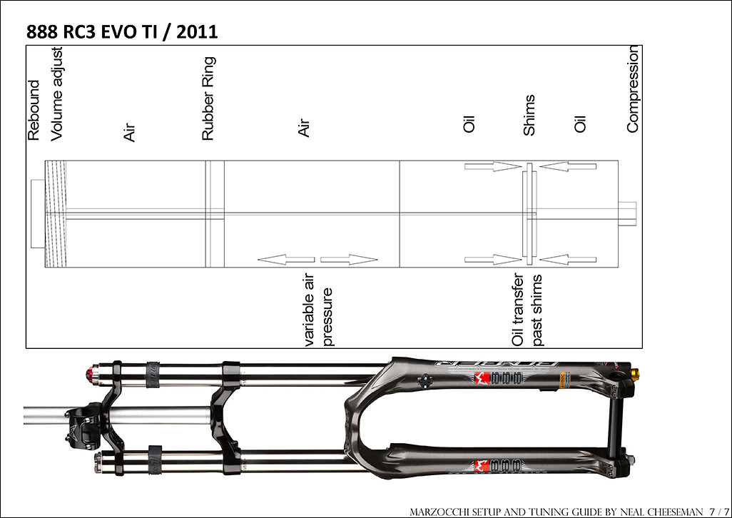

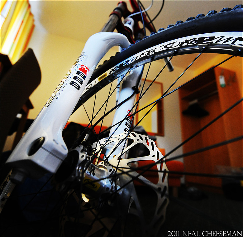

Just recently I´ve been lucky to be present at the Release of the limited edition WC Race Downhill bike from YT-Industries.
The best part of all was being able to pick the brains of the Marzocchi head mechanic, and Manager regarding the setup and tuning of their new Marzocchi 888 RC3 EVO Titanium fork....
I´ve finally put that information together, and share that with you all now with the aim of helping those who wish to get the most out of their fork.
7 photos in total so far... it is a bit rough, but should give you the idea to start with..
